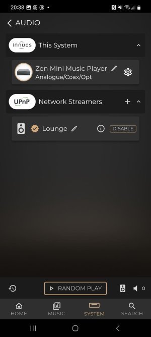

It sounds like you may be using SenseUPnP. This is an experimental feature, so it can come with some limitations and instability. For the most reliable performance, i'd recommend using the direct audio output. In your case, that would be USB, as it’s the only digital output available on your system.
As you appear to be using SenseUPnP, the best step to try would be to disable and then re-enable your Naim profile, as this can sometimes help resolve connectivity or playback issues.
How do I do this? (Re- Enable Naim profile)
btw it worked perfectly before the latest update
Still skipping tracks, generally the first if you select new album. It doesn't seem to matter how many times you try to play the skipped track, it just doesn't play.
