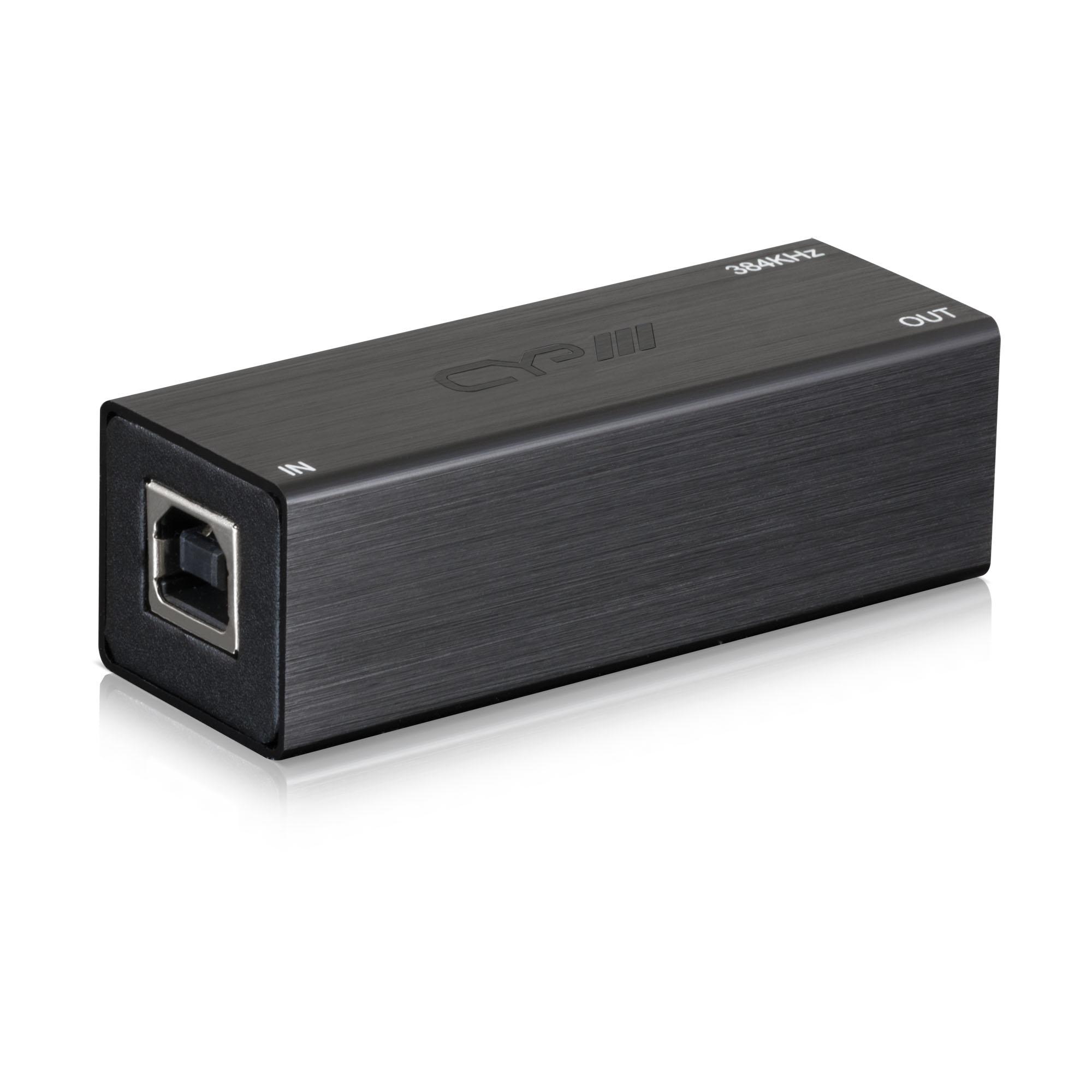

The point here is that my original reply is still relevant; PCM playback from the ZENith can only be achieved out of the USB output. The Dynaudios have no USB input. Thus, you need a DDC converter. Something as basic as this would technically do the job, though you can indeed buy more 'HiFi' ones:
