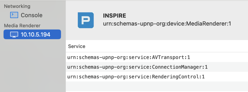

Zen Mini mk3 - 3.2.5
Plinius Inspire 980
Cannot see the streamer with UPnP enabled. Works ok with audirvana and upnp query detects the streamer and shows it as a media renderer.
