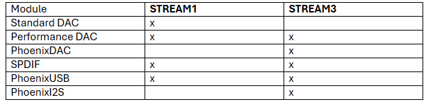

A note on Output Modules
Both STREAM1 and STREAM3 carry a dedicated output module stage (one of the key Five Pillars!) with its own independent power supply (another Pillar!) which is perhaps the biggest contributor to sound improvements over their predecessors. So in simple terms, if the question is ‘does a STREAM1 sound better than a ZENmini’ then the answer depends greatly on whether an output module is being used or the standard mainboard USB output, similar to what was primarily used on all the earlier products (except for PULSAR that had PhoenixUSB built-in). This can shift the answer from ‘yes its better’ to ‘yes, it's much better’.
To put it simply, this goes back to my earlier disclaimer of how much better is STREAM1 and 3 can only be answered with ‘it depends’. I would argue these new devices are better in almost every single aspect, but the inclusion (or not) of a dedicated output module will dictate just how much better it is in terms of sound.
Whilst on the subject, here’s a reminder of the available modules and their compatibility:
Both devices can come pre-fitted with 2TB and 4TB M2 SSD storage, and the STREAM3 also has an 8TB option.

Why does the STREAM1 not have options for PhoenixDAC, PhoenixI2S or 8TB?
The STREAM1 is physically not large enough to accommodate the slightly larger PhoenixI2S module and the same is certainly true of the significantly more sizeable PhoenixDAC kit. The comprehensiveness of the PhoenixDAC (and corresponding price) does not make much sense for the STREAM1. Similarly, an 8TB M2 SSD is quite price prohibitive in relation to the STREAM1, so we did not feel it made much sense to propose it as an option (although the STREAM1 is still completely capable of supporting an 8TB SSD).
