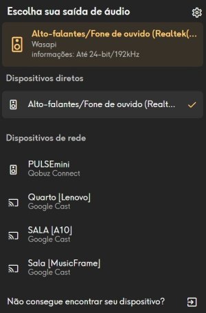

I am struggling to make that Qobuz recognise my Pulsemini as a player. It simple doesn't appear as a end player.
I am running Qobuz beta app and 3.3.1 Sense app, the PulseMini simple doesnt appear as a player, not even as a Google Cast even though the server as active the Google Cast plugin.
On the Pulse Mini side it has the analogue/optic out active but no joy to appear as a Qobuz player.
Any help would be appreciated.
Regards
Vasco

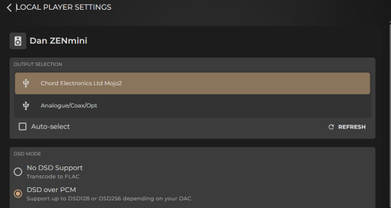

You need to have an active output enabled on your system for it to appear as an active player in Qobuz/Tidal Connect.
Check the audio settings page and confirm something is indeed enabled.

Problem SOLVED !
Thank you for Innuos Support -who promptly answer my question- and to the members of this forum .
What I made was:
a) restarted the Router
b) gave a static IP to the Innuos mini
c) install Qobuz on the PC and tried to get acess to Qobuz Connect via the desktop PC
After these steps the Pulse Mini and my PC appeared as "Qobuz Connect" end player.
Kind regards
