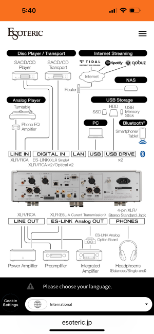

Have you connected to the Esoteric via the USB or USB-B? (The N-05XD also equips a USB B port allowing you to use it as a USB DAC for PC audio, as well as Roon Ready, giving you the freedom to tailor it to your listening environment and sound quality preferences.)
I believe if you want to use the Zenith as a storage device and feed the data stream directly to the Esoteric AND use the Esoteric internal streamer then put the Zenith on your LAN , set it as an endpoint and let the Esoteric pull from the Zenith.

Thank you Frank. This is exactly what the Esoteric U.S. importer told me yesterday. I need to use the USB A connection in order to use the Zenith as just a server. Esoteric is designed only to work with Windows and MAC OS through the USB B connection. I did not know that when I bought the Zenith. As to why I bought the Zenith as opposed to current Innuos technology...Many people have told me that I'd get better sound storing music on something other than a 4TB SSD. I was not then, and am not now convinced of that. I have friends that have NAS drives to store music and stream over their networks. The Esoteric has always sounded terrible that way, but sounds fantastic connected to an SSD. I don't know if that's due to Esoteric's design or noise on my network (which I have many month's reducing). I just know it sounds crappy. I figure I could spend $2.5k on a Zenith and just see how that works out. Now that it appears I might have to limit myself to Roon I'm not convinced it will be better than an SSD/Lumin streaming app but we'll see.
Along those lines, does anyone know where to get a high quality USB B to USB A adapter so I can try streaming via the USB A slot? I'm afraid all the adapters will degrade the sound quality. Thanks much to all for their help.

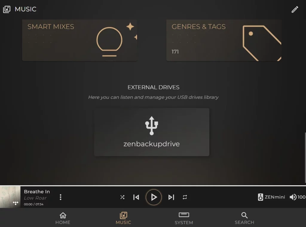

To clarify, The ZENith will not show up as an available drive when connected to the USB A port.
The USB A port on the Esoteric is for you to add an external USB drive for convenient playback. Just like you can on our systems, by adding a USB drive to playback some files that say your friend brings round for example. Its not an ideal use case on any system as external USB drives are noisy and you'll likely lack of filtering options as like ourselves we do not allow external storage to integrate with your main music library.
The optimal way to benefit from the ZENith would be to use it as the source via the actual USB audio input which is the USB B port. This is the most commonly used port used for Inputs on USB dacs.

Zenith won't work correctly using Sense through it's USB B port. The Esoteric distributor confirmed that:
"The USB-B connection on the backpanel of the N-05XD is exclusively a PC or MAC interface. It has no application for what you are hoping to achieve.
The USB-A connection on the backpanel of the N-05XD is where you would want to connect the Innous Zenith SE and be using it purely as a Server.
The input setting on the N-05XD would be set to NET."
