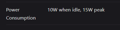

In any case, we do list the power consumption on our website:
So I would say a 15V/2A should be sufficient since that should give up to a max of 30W.
