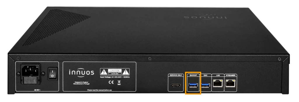

Have you tried both Backup but also DAC ports on the ZEN? The DAC port can still be used for backup, hopefully the Backup socket has not been shorted.
