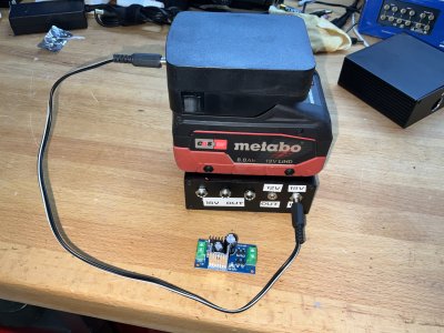

Many thanks for the quick response. My question was if 18 volts can be supplied to the MK2 instead of 12 volts. I see that the MK3 has a 9 to 24 volt range. Is the MK2 similar?

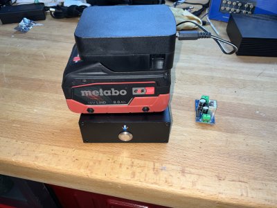

I would like to avoid an 18 to 12 volt converter in the power supply. My PSU will likely be an 18 volt 8.0 Ah CAS battery normally used for my hand held power tools. Simple and clean DC power. The small 12 volt jack is currently for Trigger output using the pictured converter.
I measured 7 to 9 watts (600 to 800 ma @ 12 volts) being drawn by the MK2. Peak of 1000ma or 12 watts. I assume the amperage would be proportionally lower with 18 volts.

I might just had a few 3 amp diodes in series to drop the voltage or a small 5 amp converter. Thanks for the feedback.

Update. Using the 12 volt voltage converter worked. I however wasn’t really pleased with the setup. The battery holder was really cheap and the battery itself would drain after a few hours meaning charging needed to be monitored. I also needed to incorporate an inline or mounted fuse at the battery holder and ideally one at the switch box.

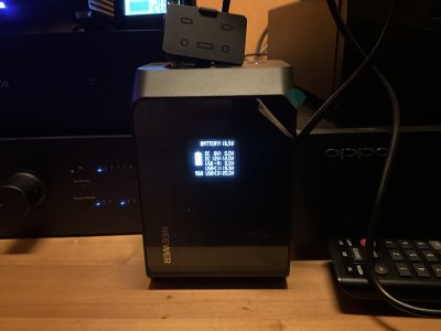

I was really curious how the smart USB-C port would react. I needed at least 18 Volts for the ProJect preamp. It worked. 20 volts supply.
Included is a wonderful display showing voltages and current on all IO’s.
