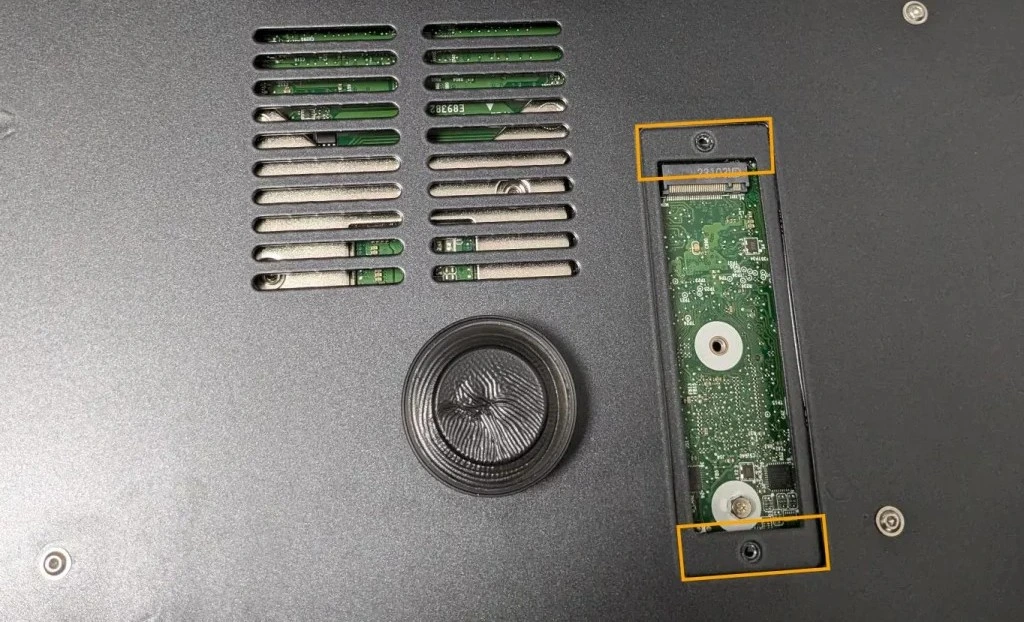

I would like to install my own SSD storage but the website does not clearly explain the location & arrangement of the internal SDD's. I understand there are 3- SSD ports inside the Zen NG series, one NVMe PCIe for the OS, another internal NVMe PCIe for storage (8GB max), and an external accessible M.2 NVMe (8GB max).
The install guide for the external M.2 slot clearly shows a 22mm x 80mm sized drive, WD Red SN700 NVMe SSD 2280.
Question is, how accessible is the open internal NVMe PCIe slot, and will it accept the exact same SSD as the M.2 NVMe above.
Reactions: frank7036
Hi Bill,
The internal drive is only intended to be accessed by Innuos and approved service partners, which is why there is a public guide only for the M2 bay found on the underside of the Next-Gen.
As an aside, I believe 8TB is not the technical capacity limit of the slot, its simply that there does not seem to be SSDs of this type that are any larger than 8TB available on the market currently. If this changes, then they may well be compatible.
