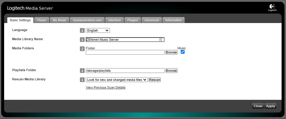

The other factor we know that could cause this behaviour is if there are additional plugins installed on the ZENmini, specifically the 'Spotty' one to enable Spotify Connect functionality. This would only be on the server if:
a) you enabled that yourself
b) you bought the ZENmini pre-owned, and the previous user enabled this.
If you bought the ZENmini second-hand or used then this is entirely possible. You can follow this guide to access the Logitech Media Server plugins:
Please go through this process to look at the list of enabled plugins, and see if you have one enabled called 'Spotty'?

I am fairly certain that the Spotty plugin i mention is the cause, and there is a chance that it was pre-installed upon purchase. So, we need to persist with the process I linked to before to access the LMS plugins page, so you have any other devices like a laptop or desktop PC that you can try the my.innuos.com on?
if that still does not work, then go to the Sense app and go to the SYSTEM tab. Here you should see an IP ADDRESS listed for your server - you can type this number directly into the web browser instead, which should then get you going through to the next steps on the guide
I have carried out your instructions and unchecked the Spotty plugin and subsequently have enjoyed 6 hours of uninterrupted volume this evening.
Fingers crossed that’s the end of the volume dropping.
